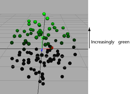

Suppose you have a 100-particle Cloud of randomly positioned particles. You turn on Shading > Smooth Shade All, add a per particle rgbPP attribute. then enter the following creation expression:
CloudShape.position = sphrand(1);
vector $pos = CloudShape.position;
CloudShape.rgbPP = <<0,$pos.y,0>>;
The three statements execute once for each particle in Cloud.
The first statement gives a particle a random position within a spherical region of radius 1. The sphrand(1) function gives the X, Y, and Z position components a value no less than -1 and no greater than 1.
The second statement assigns a particle’s position to a vector variable $pos.
The third statement assigns an RGB color to a particle’s rgbPP attribute.
The left, middle, and right vector components of CloudShape.rgbPP represent red, green, and blue components of the RGB color scheme. The third statement therefore assigns 0 (no color) to the red and blue components of a particle’s colorRGB. It gives a particle’s green component the value of its Y coordinate position.
Because a value of 0 or less results in a 0 green value, a particle is black if it’s below the XZ plane. If a particle’s Y coordinate position is above the XZ plane, it has a green component varying from nearly 0 to a fully saturated green.
This colors the particles from black to green, depending on the position.
