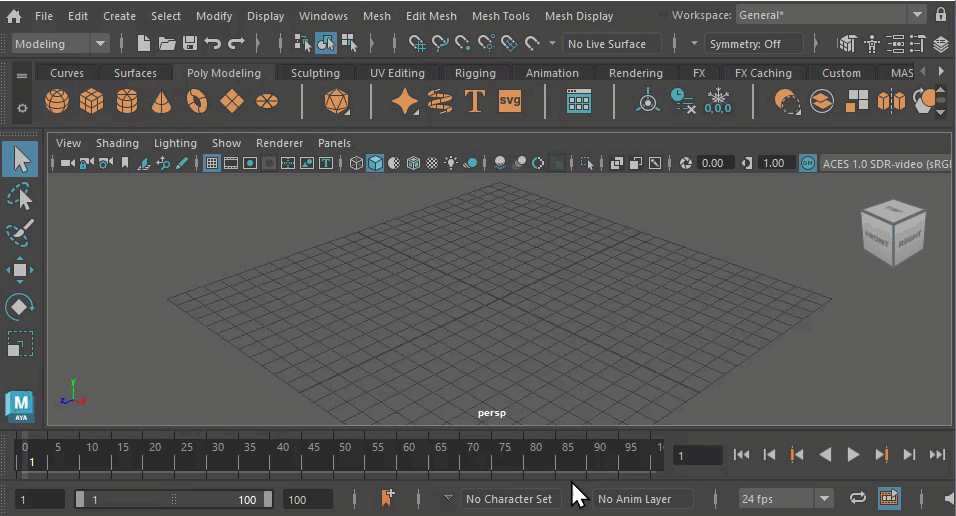

To create a custom menu set
  1. Select the Status Line menus drop-down list, and then select Customize.
    Open the Menu Set Editor
    The Menu Set Editor appears.
  2. Select Edit > New Menu Set.
  3. Enter a unique name for the custom menu set.
  4. Select Create.
    The new custom menu set appears in the Menu sets column, the Status Line drop-down list, and the Hotbox.
