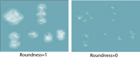

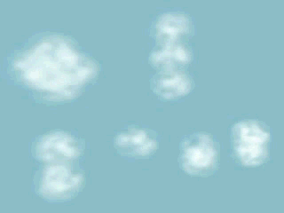

- Roundness
Controls the noise’s irregularity. The smaller the value, the less rounded the shape.
The following animation shows the Roundness attribute changing from 1 to 0.

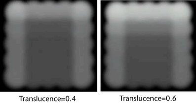

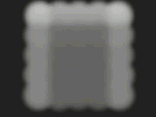

- Translucence
Specifies a scaling factor for density that is used to compute shadows only. The larger the translucence value, the more light penetrates. The formula is:
density * (1 - translucence)
The following animation shows the Translucence attribute changing from 0.4 to 0.6:.

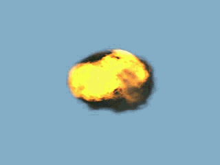

- Surface Shading Shadow
Determines if the surface shading is combined with the pre-illumination, which contains shadows, if enabled (see the Filter Radius attribute). Diffuse Coeff must be set to a value greater than 0 to enable this option.
This cloud shader uses Surface color and Surface Shading Shadow to create an explosion.
