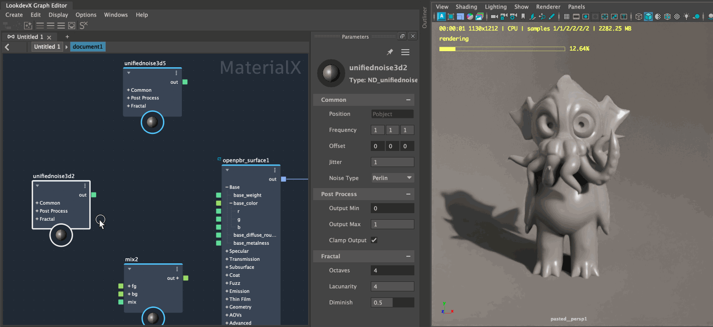

The diffuse texture (also known as albedo) is the main texture of the model. It defines the overall color of the surface. For our wooden Cthulhu, we will create a simple wood texture using a combination of two procedural noise shaders:
Large vertical stripes
This low-frequency noise will define the wood's overall structure and vertical stripes. We pipe it through a mix node to produce the appearance of a base wood color and a secondary color variation. This goes into our material's base_color property.
Dots and stippling
We use a high-frequency noise to add detailed wood grain into the material's base_weight property.
Diffuse We produce a wood-like texture by combining two colorized procedural noise shaders.
As we're using procedural 3D noise, we don't need to consider the UV layout of our model: The noise computes in 3D space and gets mapped to the surface of the object.

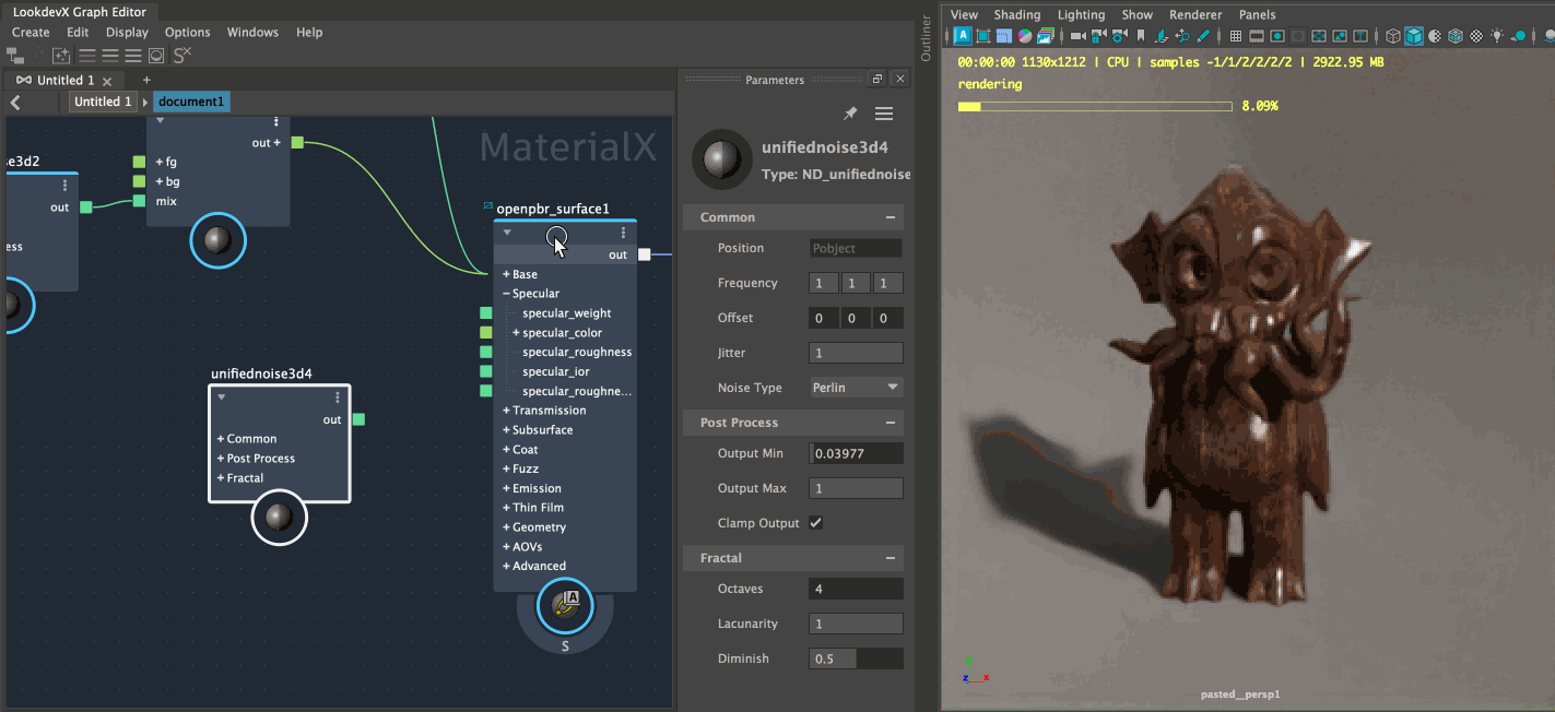

1. Specular roughness
A material's specular roughness is a key factor in determining the properties and type of surface we're looking at: it indicates whether it's a shiny new, smooth object or a rough, aged, battered one that has withstood the test of time. We can use roughness to simulate smudges on an otherwise pristine surface and various other effects.
For our Cthulhu statue, we don't want to go overboard: the original statue may have been polished at some point, but over time it has become rougher and more weathered through use. So we will introduce a modest level of overall roughness with a bit of variation across the surface to simulate wear and tear.
Similar to what we did with the diffuse texture, we use a procedural noise shader to vary the roughness across the surface of the statue.
Specular Roughness Applying procedural noise in the specular roughness helps give the surface a more natural look.

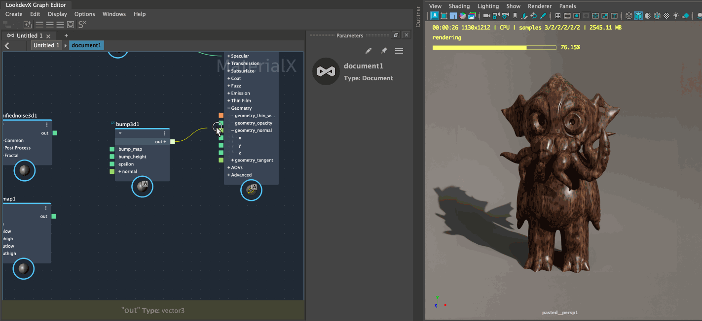

2. Bump mapping for scratches and dents
Bump mapping is a technique that creates the illusion of depth and surface detail in a material by adding perturbations to the surface normal based on a texture. Unlike displacement mapping, which actually moves the object's geometry, bump mapping is a simple surface effect and is much faster to render and easier to set up.
We will apply bump mapping to create the appearance of random scratches, dents, and other marks on the surface of our statue.
However, we want to focus these weathering effects in specific areas of the statue that are more exposed or have sustained wear through use:
  • Thinner parts are more likely to have chipped or carved away over time
  • Edges and corners are more likely to have suffered from wear and tear from bumps and knocks
For this, we use another procedural utility—the Arnold Curvature shader. It's a powerful and flexible shader that can detect creases, edges, and other surface features. We use its output to mask the intensity of our bump-mapping noise, focusing the weathering effects in the desired areas.
Bump Mapping We use bump mapping to create the appearance of random scratches and dents in thinner parts, edges, and corners.

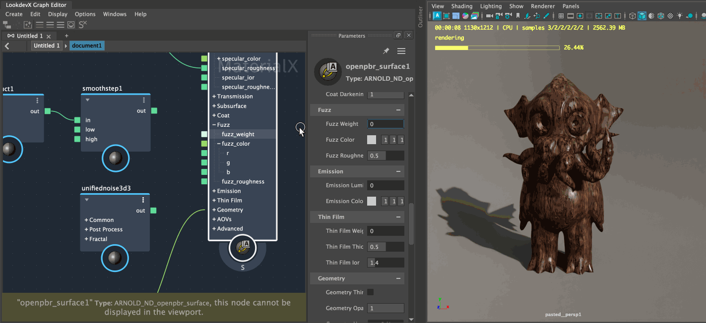

3. Finishing touches: Procedural dust
The final touch we will add to our statue is some procedural dust.
Dust is a common occurrence on aged objects. Over time, dust tends to accumulate in crevices and corners, but in particular on surfaces facing upwards.
We will use the material's Fuzz property to simulate the appearance of dust on our statue. To limit the dust to upward-facing surfaces, we use a dot product node to compute the surface direction and use this as a mask for our Fuzz property. Finally, the smoothstep node allows us to adjust the intensity of the dust to our liking.
Procedural Dust We use procedural shaders to limit the dust to upward-facing surfaces.

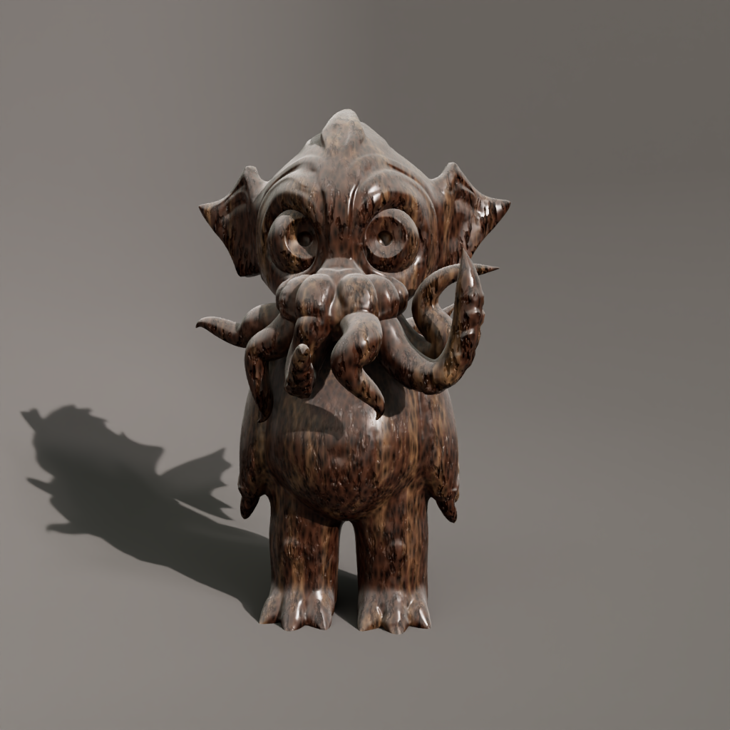

Final Result The final result is an aged wooden statue covered in dust using only procedural shaders.
