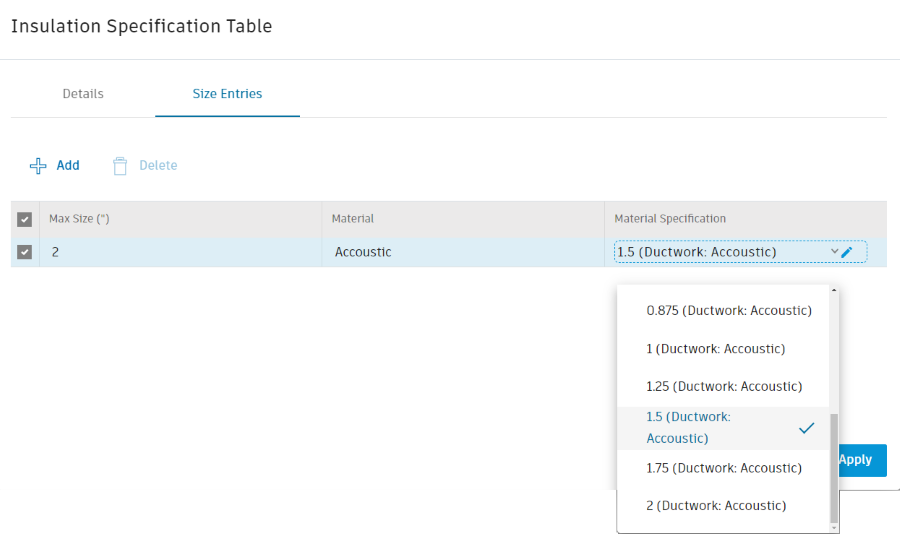

  4. To specify the sizes' insulation breakpoint, click add-24 Add under Tables.
  5. Click on Size Entries.
  6. Define the Max Size with its associated insulation thickness and type.
insulation specs size entries
Note: You can add multiple size rules if necessary.
  1. Click Apply.
A new insulation specification is now created.

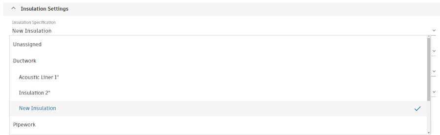

Assign the insulation specification to a service
  1. In the navigation pane, click Services.
  2. You can select an existing service and click edit-24 Edit, or click add-24 Add to add a service.
  3. Click the Insulation Specifications drop-down and select the insulation specification you created before.
    InsulationSpecList
