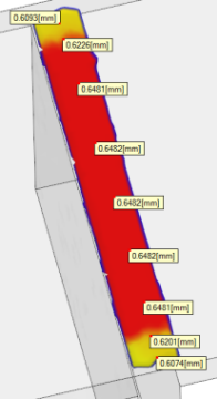

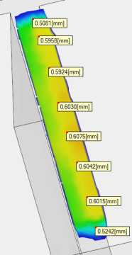

The Sink mark estimate result now uses a standardized and improved method for predicting sink marks.
Prior to this release, sink mark estimates across mesh types and products varied. This was due to historical differences in approach to the way sink marks were calculated. The algorithms are now standardized, and provide a more consistent and reliable result.
The images above show the results, from left to right, for the same part meshed with a midplane, Dual Domain, and 3D mesh.
