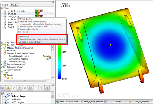

To view Study Notes without opening the study
Hover over a study.
A dialog appears with information about the study. If there are study notes associated with the study, they will appear at the bottom of the dialog under the heading Study Note.
