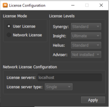

The License Configuration tool can be accessed from the Windows Start menu, located in the Autodesk Moldflow Adviser folder.
Named User License configuration
Named user License configuration
Once you activate the License Configuration tool, select the License Mode you wish to apply.
With the Named User license the default license is:
  • Adviser Ultimate
Click Apply to accept your Named User License setup and close the License Configuration tool.
