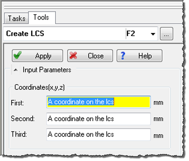

  1. Select (Geometry tab > Local Coordinate System panel > Create LCS), to open the Create LCS dialog
  2. In the Filter drop-down list at the bottom of the dialog, select the type of model entity that you want to snap to, when you click in the model pane.
  3. For each of the 3 Coordinate boxes in turn, either enter the required coordinates using the keyboard, or click on the required location in the model pane.
  4. Click Apply to create the local coordinate system.
  5. Click Close to close the Create LCS dialog.
