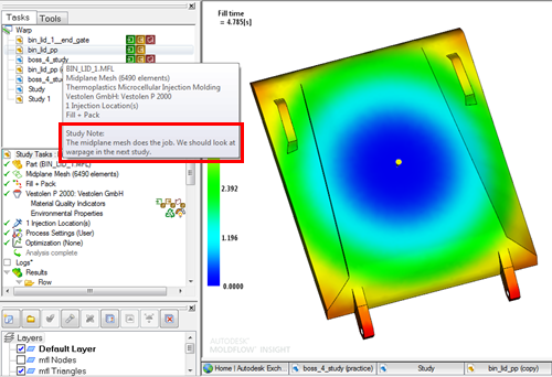

To view Study Notes without opening the study
  • Hover over a study.
    A dialog appears with information about the study. If there are study notes associated with the study, they will appear at the bottom of the dialog under the heading Study Note.
