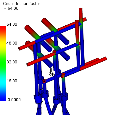

Circuit friction factor result
The friction factor determines the frictional losses in the channel, and is dependent on the sand grain roughness factor, (e/D), of the channel and the Reynolds number, Re, of the fluid flowing through it. This correlation is shown empirically in the Moody diagram. By default, the software uses the Swarmee-Jain approximation to the Colebrook-White equation to provide a numerical solution to the Moody diagram. This result enables you to see where in the circuit there are frictional losses.

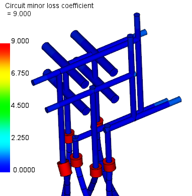

Circuit minor loss coefficient result
The minor loss, or K factor, is the resistance to flow contributed by each elbow, bend, T Junction, and change in dimension, in the channel. In cooling circuits, these minor losses can become significant. By default, the software calculates an approximation for the minor losses, which you can see in the Circuit minor loss coefficient result. To obtain more accurate results, you can enter K factors from the manufacturers of your circuit components.
