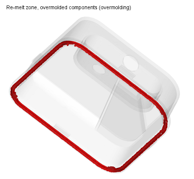

This tutorial familiarizes you with the setup of the two-shot overmolding process, and helps you to review key results. It is expected that you understand the two-shot overmolding process.

The figure above shows the Re-melt zone plot, which is an important result from an overmolding analysis. You will review this result later.
