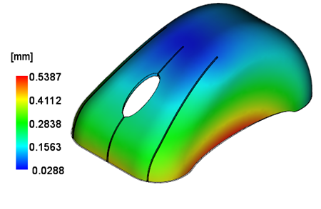

Select the Deflection, all effects:Deflection result in the study tasks list.
The variations in results from cavity to cavity for fill time, pressure, temperature, and volumetric shrinkage will cause small differences in deflection between the parts. Your deflections will be slightly different than the examples in this tutorial, but close enough to determine if there are any problems.
Click
(Results tab > Properties panel > Plot Properties).Click the Deflection tab.
Enter 5 for the Scale Factor Value and uncheck the X and Z directions to display the Y direction only.
Click OK.
Rotate the part so you can see the slits from the core side.
The deflection of the part is scaled to be 5 times greater than actual. This is done to see the deflection on the part easier. It appears that the center slit is OK but the outer two overlap. In reality, there is no overlap as that is not possible. What it does say is that the outside corners of the mouse deflect more than the center, causing the narrowing of the slit. This warpage should be improved.
