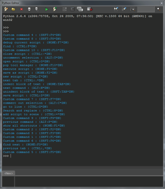

To access the list of Python Editor keyboard shortcuts:
From the MotionBuilder menu bar, select Window
Python Editor.
The Python Editor window displays.
If there are lines of code in the interactive console, click the Clear interactive console tool
in the Python Editor toolbar. If there are no lines of code, proceed to the next step.
In the Python Editor toolbar, click the Python context Help tool
or press F1.
Python Editor commands keyboard shortcuts
The Python Editor interactive console displays the list of Python Editor keyboard shortcuts.
The Python Editor keyboard shortcut mappings are listed in the PythonKeyboard.txt file located in the following default directories:
- C:\Program Files\Autodesk\MotionBuilder Danko (64-bit)\bin\config\Python\Keyboard
- C:\Program Files (x86)\Autodesk\MotionBuilder Danko (32-bit)\bin\config\Python\Keyboard

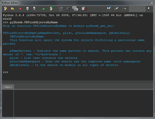

To display context help related to a command in the interactive console:
Make sure the interactive console is active.
In the Python Editor toolbar, click the Python context Help button
or press F1.
The Python Editor interactive console displays help related to the command entered in the interactive console.
Help about a command in the interactive console
To display context help related to selected content in the interactive console:
Select text in a line of code in the interactive console.
or press F1.
Help related to the selected text is displayed in the interactive console.
Tip: To see all the content displayed in the interactive console, you can either resize the Python Editor window by dragging any corner or border of the window or adjust the height of the interactive console (without resizing the Python Editor window) by dragging the bottom border of the interactive console.
