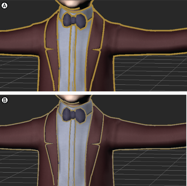

Antialiasing | Activate Antialiasing to add an anti-aliased edge to the selected edges. For example, the following graphic shows the difference between the edges drawn without Anti-aliasing, and with Antialiasing activated. For both objects, the line width is set to 4.0, and the Edge Cartoon shader is appended over a Flat shader. The Antialiasing option uses the material color of the object or the custom material you applied in the Materials settings. If you apply a Flat shader with the Edge Cartoon shader, make sure the Flat shader is set to Material Color. |
Anti-aliasing A. Without anti-aliasing. B. Anti-aliasing is activated.
