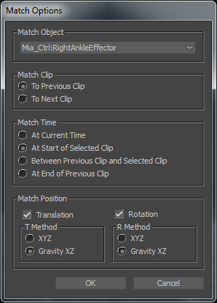

  4. In the Story window controls, click the Match options .
    The Match Options dialog displays.
  5. Make sure the options selected match what is shown in the Match Options dialog figure and then click OK.

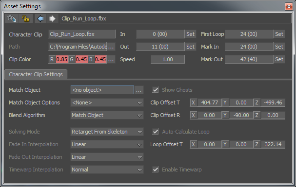

    An empty Asset Settings dialog displays.

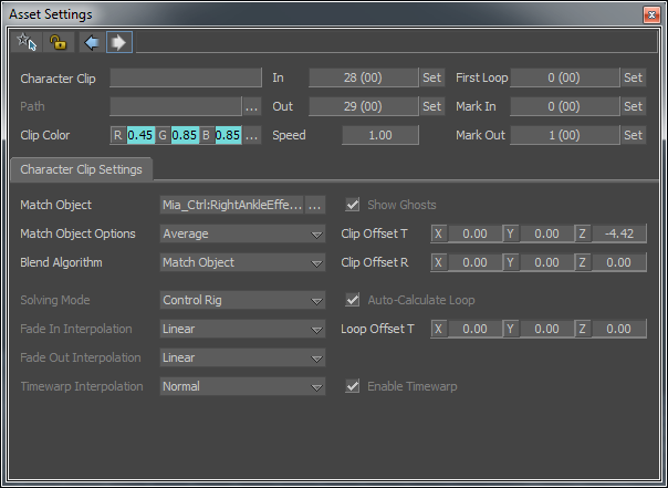

  7. In the Story window Character Track, double-click the second clip.
    The Asset Settings dialog displays the Character Clip settings and options.
  8. In the Character Clip In field, set a value of 23.
    The second clip now starts at frame 23, and cross-blends with the first clip to end at frame 29. This blend creates a slightly smoother transition between the clips.
  9. Close the Asset Settings dialog.
