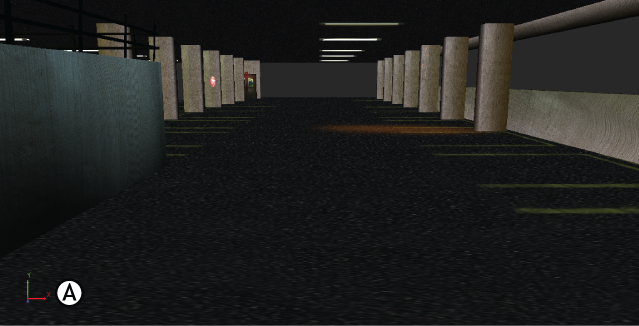

The Axis option in the Camera settings View area lets you show or hide the axis arrows that shows the scene’s orientation.
Scene A. Axis
Note: The axis shows in all camera views by default.
To show the camera’s axis:
  1. Right-click a camera in the Scene browser or Viewer window and select make Current from the context menu.
  2. In the Navigator window, activate the Axis option in the Camera Settings View area.
