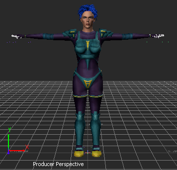

In the Viewer window, a model named Mia appears in the T-stance.
Mia in the T-stance
Note:This model was created in Autodesk Maya, and the bones were named according to the bone naming conventions in the MotionBuilder Mapping list.
