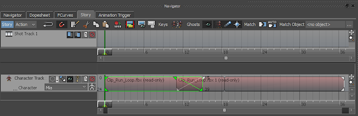

In the following procedure, you blend two clips to remove a jump in animation that occurs when Mia turns.
To blend two clips:
Note:
This procedure assumes you have just completed the previous procedure.
See Create a turn.
  1. In the Story window Controls, ensure the Loop/Scale option is set to loop ( ).
  2. From the menu bar, choose Window Add Asset Settings.
    An empty Asset Settings dialog displays.
  3. In the Story window Character Track, double-click the first clip.
    The Asset Settings dialog displays the Character Clip settings and options.
  4. In the Character Clip Out field, set a value of 15.
    The first clip overlaps the second clip, creating a cross-blend.
  5. Close the Asset Settings dialog.
  6. Play the animation.
    • In the Action Timeline, J-drag jog through frames 8 to 16 slowly.
    There is no longer a jump at frame 11.
