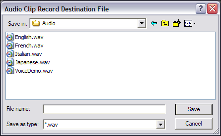

  3. A dialog box appears so you can select a location to save your .wav file.
    Audio Clip Record Destination File window

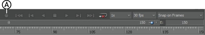

  4. When you are ready to record, click Record in the Transport Controls.
    Transport Controls A. Record button
  5. Both the path and file name of the new .wav file appear in the field beside the Record button.
