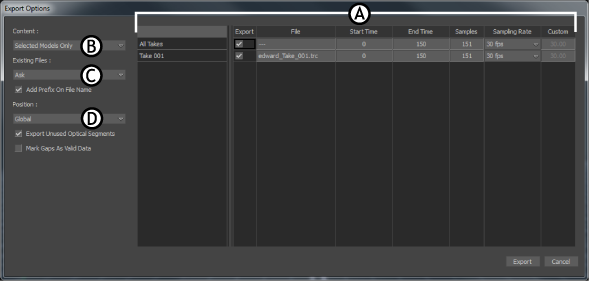

If you select a motion file or skeleton file format, the Export Options dialog box displays when you click Save. This is where you specify the appropriate parameters for the motion file type you are exporting.
Export Options dialog box with two takes A. Export Table B. Content area C. Existing Files area
The Export Options dialog box is split into the following areas:

The options that appear in the Export options dialog box depend on the file format you exporting to. When you export a motion file, there are two main considerations:
- the skeleton's naming scheme
- the skeleton's hierarchy
For hierarchical formats such as Biovision .bvh, Motion Analysis .htr, Acclaim .asf and amc, you must select the root node because this node becomes the root for the resulting exported file.
Note: In many cases the root node is the pelvis or hips node. The root node is where the translation occurs since translation is only saved for the root node.
The hierarchy requirement specifies the order in which every joint of a skeleton is the child of a parent joint, with the exception of the root joint. You must select the proper node for the file format you select, otherwise warning dialog boxes appear and the export is aborted.
