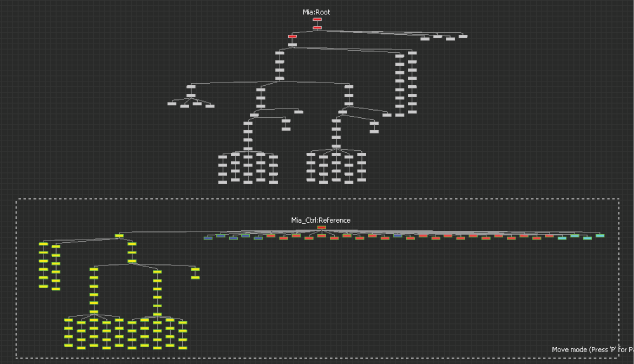

  1. In the Viewer window, switch to Schematic view (Ctrl-W). Select all of the nodes in the Control rig you want to save.
    Select the nodes of Mia’s Control rig in the Schematic view.

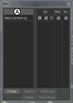

  4. Right-click the set, select Rename from the context menu, and rename the set to reflect the name of your Control rig.
    Sets window A. Renamed set containing Control rig
