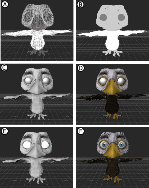

Models Display
The Models Display menu option contains global shading options that apply to the entire scene.
Models Display options A. Wireframe B. Flat C. Lighted D. Shaded E. Textured F. Shaded & Textured
Note: You can undock this window from the interface. See Rearranging the interface.
The Models Display menu options are:
| Models Display option | Description |
| Wireframe | Displays selected objects as wireframe. |
| Flat | Displays selected objects using a constant color. This option ignores light sources in a scene, and overrides any custom shading, textures, and materials applied using the Shader settings. See About shaders. |
| Lighted | Displays selected objects using their custom shaders created in the Shader settings. Textures do not display. |
| Textures | Displays selected objects with their applied textures. This option is available only when the Lighted option is selected, in which case Use Textures is active by default. See Textures. |
| Shaders | Displays selected objects using the default shader. This option is available only when the Lighted option is selected, in which case Use Shaders is active by default. |
| Textures + Shaders | Displays selected objects with both the default shader and their applied textures. |

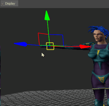

Hide Manipulators while Manipulating
When turned on, all manipulator elements (translate, rotate, scale) are hidden while manipulating the selected object. The option is turned off by default.
