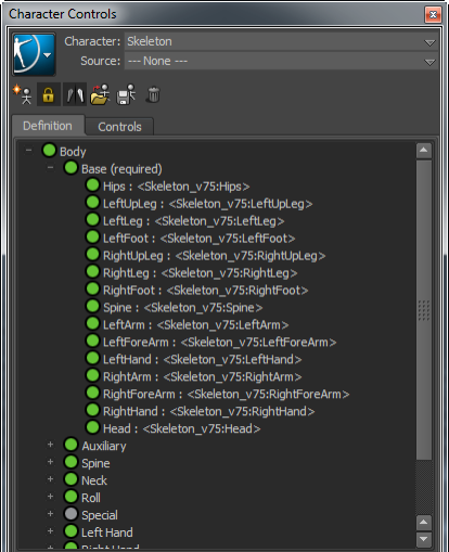

Name Match view
Displays all bones in a list, grouped according to their related body part or IK effector. Use this view to get an overview of your skeleton definition, and to view the names of the bones assigned to multiple different nodes. You can map bones to the Name Match view using the same methods as in the Character view.
