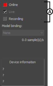

Devices behave relative to live data or recorded takes. When a device is active, the Record and Play options display with the device’s settings, letting you set the device’s online, live, and recording state.
A. Record and Play options in the Device settings.
These options determine whether the device is being used live, is being recorded, or is using previously recorded data. You can set options for an entire device, or for selected properties of a device.

Online
Use the Online option to activate and disable each device. When a device is Online, it is active and ready to be used by MotionBuilder.
Disabled devices do not send live data to MotionBuilder. If a device keeps switching off when you are trying to turn it on, it means that MotionBuilder cannot find the device, or its port is being used by another device.
Live
There are two different types of play modes: Live and Recorded. Disabling the Live mode sets the play mode to Recorded, and takes the data from the current take, from the device, or its bound model. The current take displays in the Transport Controls window.
Activating the Live mode sets the play mode to Live, and inputs data directly from the device instead of a recorded take.
Note:
The Live and Recording play modes are not available to devices designated as output only.
Recording
When the Recording option for a device is active, you can record the data from the device to the current take. You can record all the data from a device, or you can choose individual attributes to record.
For example, if you are recording data from a mouse device and you only want to capture the data from the Y-axis, activate Recording for the Y-coordinate, and disable Recording for the X-coordinate.

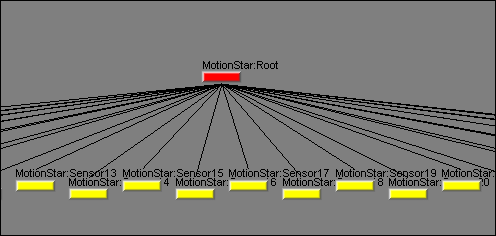

Depending on the device, the bound model displays as a group of sensors, as a single null, or as a skeleton structure in the Viewer window. The bound model displays as a hierarchy in the Schematic view.
Bound model in the Schematic view
