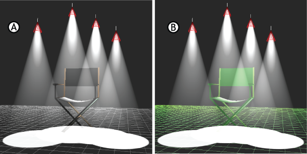

By default, the color of the fog is pure white.
A. Fog settings disabled B. Fog settings activated and fog color set to green.
