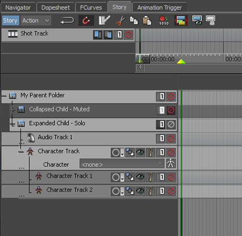

Run the manipulate_story_folders_and_tracks.py
script to see how the story tracks are organized into folders (FBStoryFolder
) and how you can manipulate the FBStoryFolder
. For example, you can make the FBStoryFolder
appear collapsed or expanded, mute all the tracks in the FBStoryFolder
, and so on.
