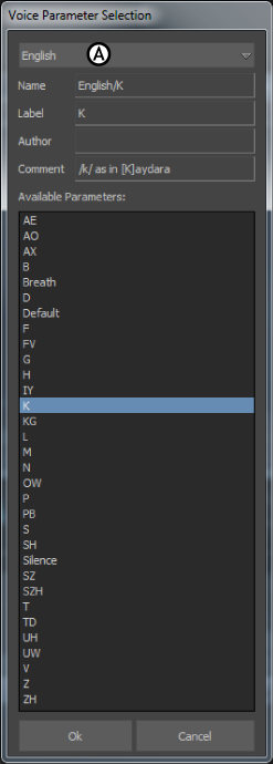

Voice Parameter Selection dialog box
The Voice Parameter Selection dialog box lets you select the types of sound parameters you want to add to the Voice device, including phonemes and various instruments that measure sound properties.
Voice Parameter Selection dialog box A. Parameter type menu
The Parameter Type menu lets you select the following groups of sound parameters:
- Instruments parameters
- English parameters
- Compatibility parameters
- Common parameters
