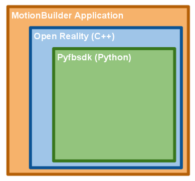

API Organization
The MotionBuilder SDK provides two Application Programming Interfaces (APIs), one in C++ and the other in Python.
- The MotionBuilder C++ API is contained in the Open Reality SDK (OR SDK).
- The MotionBuilder Python API is contained in the pyfbsdk module.
The majority of MotionBuilder's functionality is exposed in the C++ API. The Python API is a subset of the C++ API, and was generated using the Boost Python library. As a result, the function signatures of one language are analogous to the other.
