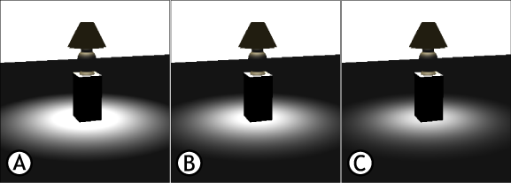

Attenuation
The Attenuation settings lets you specify how the intensity of a light drops off in relation to the distance from the source. Once you add a Dynamic lighting shader, use this setting to set how MotionBuilder calculates the light falloff. There are two options, Linear and Quadratic, that affect lighting falloff. No Attenuation disables the falloff effect.
Light attenuation setting: A. None B. Linear C. Quadratic. Compare the edges of the shadow.
Do not change the attenuation setting if you do not want to the lighting influenced by its distance from the source.
You must apply a Dynamic Lighting shader to the scene to see attenuation effects. See Dynamic Lighting shader settings for more information.
| Setting | Function |
| Linear | This setting produces an even falloff. The equation is (intensity/x). The light will drop off in an even fashion from the point it leaves the light until it illuminates an object. |
| Quadratic | This setting produces an uneven falloff. The equation is (intensity / x squared). The light will make a rapid drop off close to the object and the falloff will then slow the further it gets from an object. |

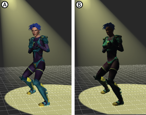

Cast Light on Object
Lets you use the light as an effect in the scene without illuminating objects. For example, the following figure shows a model with Cast Light On Object activated and disabled.
Cast Light On Objects A. Disabled B. Activated
When the Cast Light On Object option is activated, objects are lit. When the setting is disabled, the light effect exists but does not affect the object.
Disabling Cast Light On Object speeds up the display time. The Cast Light On Object option is activated by default. If you want only to have some objects affected by particular lights in your scene, see Selective Lighting shader settings.
