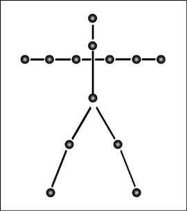

Each point is placed in 3D space and connected together to resemble the joints of a human skeleton. For example, the following illustration shows a very simplistic skeleton created with dots representing the joints, and lines representing the bones. What is drawn between the joints is not important at this stage.
The series of dots represent joints that are connected with lines (representing bones). The next section discusses the relationships and rules needed to make this series of points act like a human skeleton.

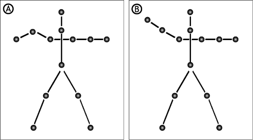

Refer again to which uses dots to represent joints. With no relationships established, each joint moves independently.
For example, if you move the dot representing an elbow, only the elbow moves and the wrist and hand do not move. On a human skeleton, if you move your elbow, the wrist and hand move as well.
A. If no relationships are established to define the movement of the right arm on the simple skeleton, it moves in an unnatural fashion. B. A rule is created to make the wrist and hand move when the elbow moves, resulting in natural movement.
To create natural movement, you need a rule that says “when the right elbow moves, the right wrist and hand must also move”.
You also need a rule to govern the rotation of joints. Through studying human movement, it is obvious that when, for example, the right elbow moves, the wrist and hand also move, and the right shoulder rotates. So you create a rule that says “when the right elbow moves, the right shoulder rotates.”
