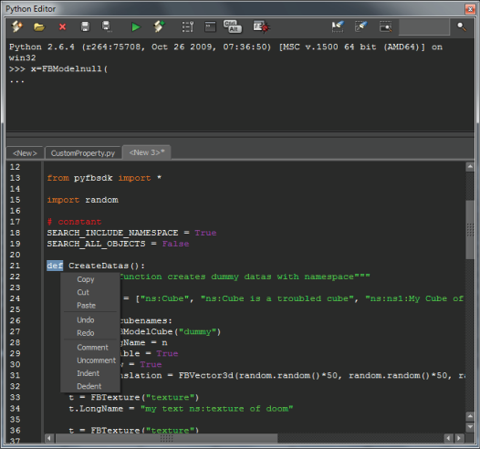

To copy, cut, paste, undo, redo, comment, uncomment, indent or dedent:
  • Right-click to choose an option from the context menu.
    Python Editor work area context menu displayed
