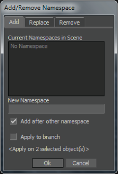

The Add/Remove Namespace dialog box appears, displaying namespaces in the current scene.

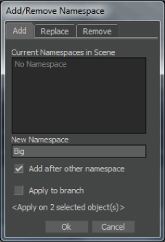

Click the “Add” tab.
Click in the “New Namespace” field and enter characters.
Namespace specified for selected object
Enabling or disabling the option “Add after other namespace” option when there are no namespaces in the scene has no effect.
Warning:Adding namespaces to objects may affect the merge-back of the animation as this process is based on the names of objects.
Click OK.
The specified namespace is added to the object, giving the object a unique name.

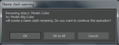

If you have two objects in a scene that carry the same name (for example “Cube”) but one of the objects has a namespace prepended (for example “Big:Cube”), prepending the same namespace (for example “Big”) to the object carrying the same name (for example “Cube”) gives the following warning message.
Name Clash Warning dialog box
If you choose to proceed with the action, a number is prepended to the object’s name to give the object a unique name (for example “Big:Cube1”).

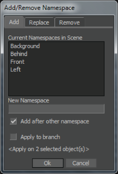

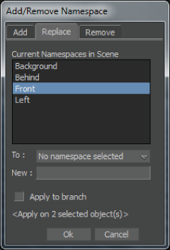

Click the “Replace” tab.
The selected object’s namespace is highlighted.
Click in the “New” field and enter a name.
Warning:Changing namespaces of objects may affect the merge-back of the animation as this process is based on the names of objects.
Click OK.
The object’s namespace is replaced by the specified name.
