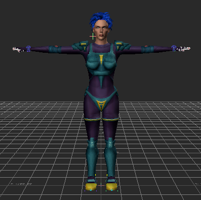

  4. In the Asset browser display pane, click the mia_rigged asset (mia_rigged.fbx file) and drag the asset in the Viewer window.
    The FBX Open context menu displays.
  5. Select FBX Open No Animation.
    In the Viewer window, a model named Mia appears in the T-stance.

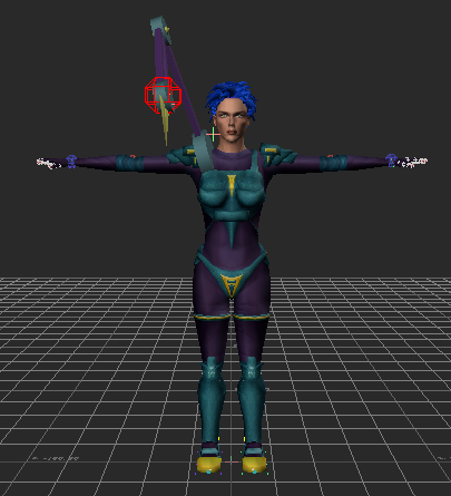

  6. In the Asset browser display pane, click the servo asset (servo.fbx file) and drag the asset in the Viewer window.
  7. Select FBX Merge .
    In the Viewer window, a Servo arm is positioned over Mia’s shoulder.
    Mia and Servo arm loaded into the scene
