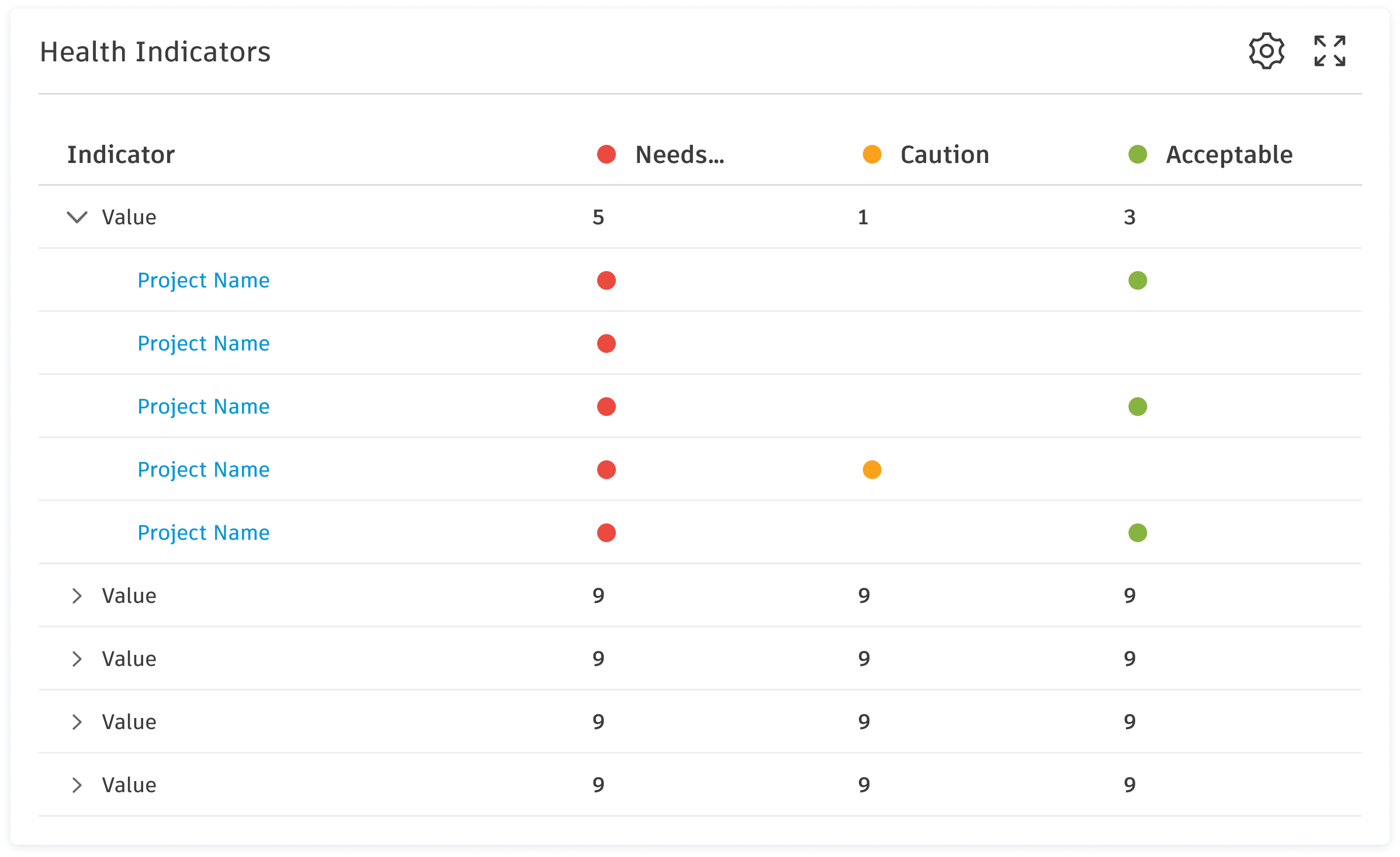

| Health Indicators | ✓ | ✓ | ✓ |
| Revit Warnings | ✓ | ✓ | ✓ |

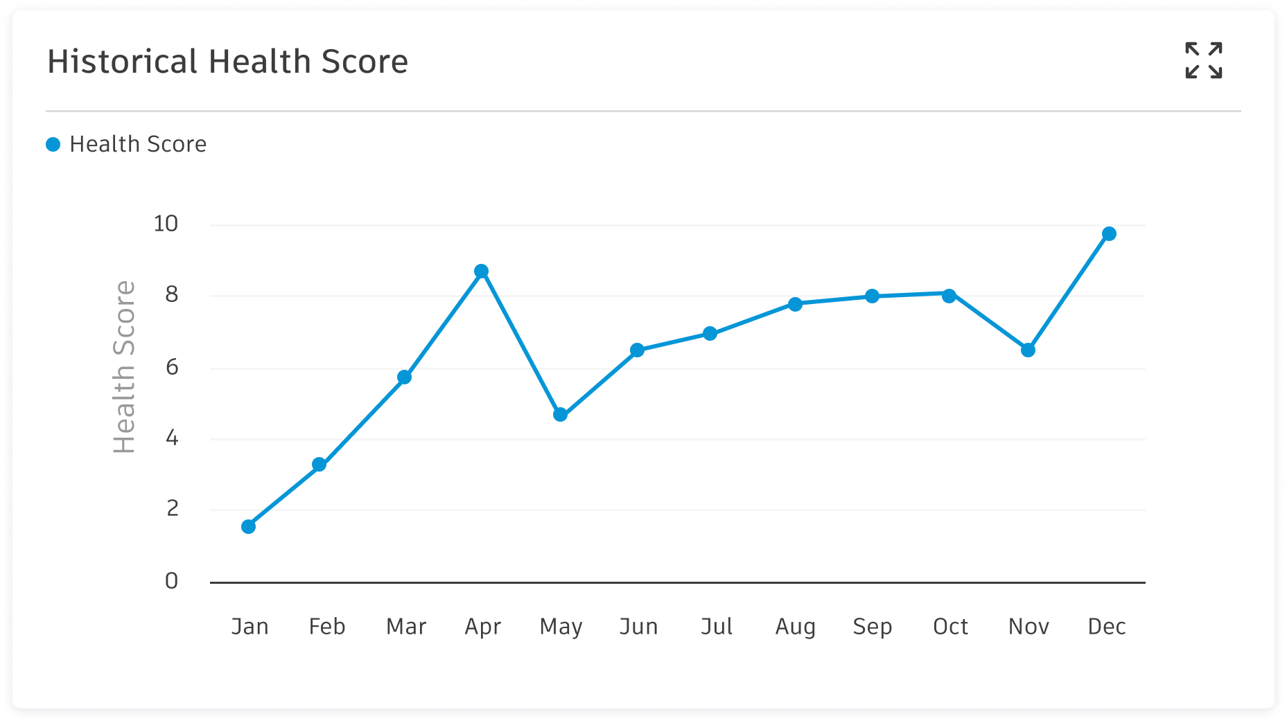

| Historical Health Score | — | ✓ | ✓ |

Health Score and Health Indicators
Health Scores and Health Indicators use the same definitions and calculation logic in both Model Report and Project Report. The only difference is scope:
- Model Report calculates results for a single model
- Project Report aggregates those same results across multiple models

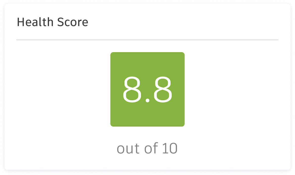

Health Score
Health Score Calculation
The Health Score provides a measure of overall project or model health based on the status of individual indicators. Each indicator is classified into one of 3 categories, and then converted into a weighted score.
| Classification | Weighted Score |
| Acceptable | 2 points |
| Caution | 1 point |
| Needs Attention | 0 points |
To normalize this value, the sum of the weighted scores is compared against the maximum possible score:
Maximum Score = 2 × Total # of Indicators
The final Health Score is then computed on a 0–10 scale:
Health Score = ((2 × Acceptable + 1 × Caution) ÷ (2 × Total Indicators)) × 10
The result is displayed rounded to one decimal place.
Health Score Ranges
The Health Score is visually categorized to indicate overall status:
Red (< 5.0) indicates poor health and requires immediate attention.
Orange (5.0 – 7.7) indicates moderate health with areas that may need improvement.
Green (≥ 7.8) indicates strong overall health.
Each range is reflected in the background color of the Health Score card, providing a quick visual summary of system status.

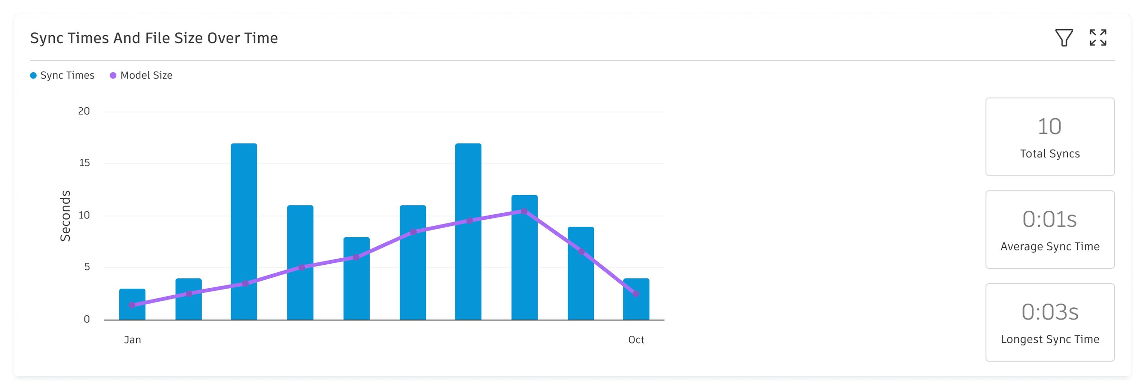

Sync Times and File Size over time
How are sync performance and file size changing over time?
Each sync is visualized in 2 ways: Sync Time (in seconds) is shown in bars, while File Size is shown as a line, tracing how the file size changed across those same points in time.
Model Report shows sync performance and file size for a single model, while Project Report aggregates those signals across all models in the project.
If Sync Times spike, you can see what changed between updates to identify the cause.
Model Report defaults to the last 7 days for recent, model-level analysis, while Project Report defaults to the last 30 days to provide a broader view of project-wide trends. You can expand or narrow the date range when you want to investigate patterns over time.
As you explore, you can hover over bars to get more context such as project details, exact timing, and model size.
