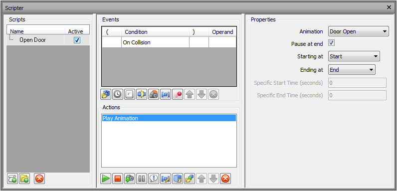

    The Scripter window is a floating window that enables you to add interactivity to object animations in your model.
    Ribbon: Animation tab > Script panel > Scripter
    The Scripter window contains the following components: the tree view, the Events view, the Actions view, and the Properties view.
    Note: If you can’t use any of the controls in the Scripter window, it means that you are in interaction mode. To exit the mode, click Animation tab > Script panel > Enable Scripts.
