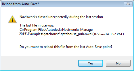

In the event that Navisworks closes before you save changes to your file, you can either automatically reload the last file you were working on, or manually load a backup file.
Open Navisworks.
To open the most recent saved version of the file you were working on, click Yes on the automatic prompt:
To manually load a backup file, Click No on the prompt, and then click the application button

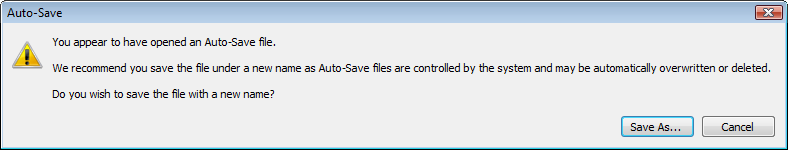

When you are prompted to save the file with a different name, click Save As.
In the Save As dialog box, enter a new file name, and browse to the desired save location.
Click Save.
