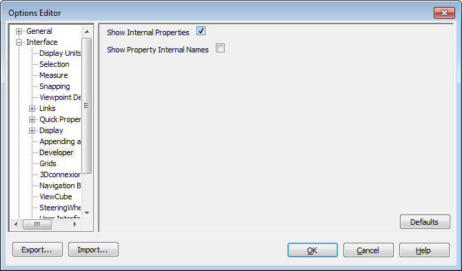

Use a Developer Profile
Click the application button
> Options.Expand the Interface node, and click the Developer option.
Select the Show Internal Properties check box to add additional object properties to the Properties window.
Click OK.
