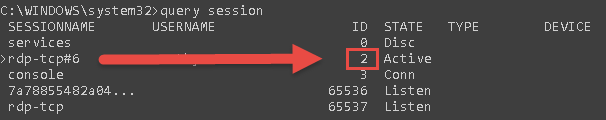

Determine the remote desktop session ID
  1. At the command prompt, type query session and press Enter.
  2. Find the numerical ID in the rdp-tcp row (typically 1 or 2).
