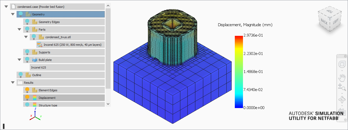

- With the copied geometry and results files, and a .case file correctly formatted to read them, we should have a functioning, condensed set of results which can be used for archiving or sharing. It is always good practice to open up the edited case file to ensure it is working properly before sharing the file and deleting the source results.
Import the condensed.case file into Simulation Utility for Netfabb via the Import Results Function, by simply dragging and dropping into the software. Look at the results to confirm they are correctly formatted and identical to the source results.
For this small example, we were able to reduce the shared file size from 105 MB to 3.17 MB, a reduction of 97%, which indicates how useful this technique can be when applied to large and complex models.
