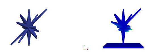

This warning indicates that the numbered element is not connected to the existing part or substrate, which would result in a non-physical floating mass, and has been removed from the mesh. Rotating the build volume or adding support structures can eliminate these warnings.
Disconnected elements
In the figure on the left, you see a complex part. On the right is the solved simulation. Unsupported elements radiating downward have been removed because they could not be built from the bottom up.
