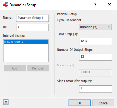

Share Email Facebook Twitter LinkedIn Tutorial A7: Define Dynamics Setup and Run Analysis Under Subcase 1, right-click Dynamics Setup 1 > Edit. Set the following values: Cycle Dependent: Duration (s) Time Step (s): 4e-6 Number of Output Steps: 25 Click OK. Right-click Analysis 1 > Solve in Explicit > Solve. Parent topic: Tutorial A7: Explicit Dynamics Analysis of a Chain
