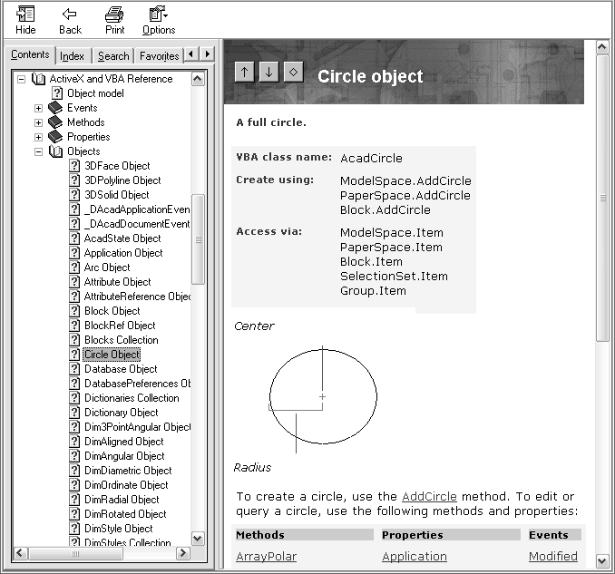

If you do not know what function adds a circle to an AutoCAD drawing, you can figure it out by looking in the ActiveX Reference. If you look up the definition for the Circle object, here's what the entry looks like:
Sometimes, as in this Circle topic, there is descriptive text that identifies the method you need. Often, though, you will need to look through the list of methods to find the one that matches the action you want to take.
Once you find the name of the method, add a vla- prefix to the method name to get the name of the AutoLISP function that implements the method. In this example, it is vla-AddCircle.
