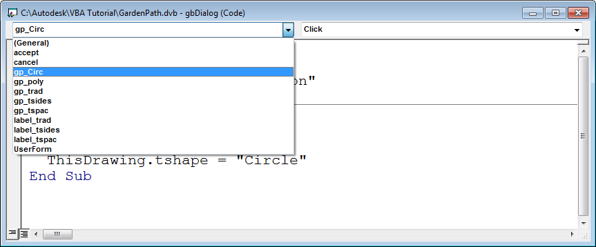

  1. On the Project window, right-click the gpDialog user form and click View Code.
  2. In the Code window, click the Objects drop-down list on the left and select gp_poly.
  3. In the Procedure drop-down list, select Click if it is not selected by default.
  4. In the Private Sub gp_poly_Click procedure that is added, enter the following code statements:
    gp_tsides.Enabled = True
      ThisDrawing.tshape = "Polygon"
    The code enables the gp_tsides text box and sets the tshape variable of the ThisDrawing module to the text string Polygon.
  5. Add the Click procedure for the gp_circ object and enter the following code statements:
    gp_tsides.Enabled = False
      ThisDrawing.tshape = "Circle"
    The code disables the gp_tsides text box and sets the tshape variable of the ThisDrawing module to the text string Circle.

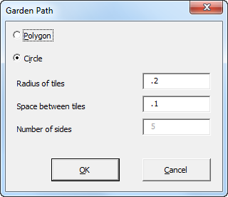

  8. Add the Initialize procedure for the UserForm object:
    Private Sub UserForm_Initialize()
      gp_circ.Value = True
      gp_trad.Text = ".2"
      gp_tspac.Text = ".1"
      gp_tsides.Text = "5"
      ThisDrawing.tsides = 5
    End Sub
    This event handler is executed when the user form is loaded the first time in a session.

  6. In the Garden Path dialog box, click Polygon.
  7. In the Radius of Tiles text box, enter .5.
  8. In the Space Between Tiles text box, enter .05.
  9. In the Number of Sides text box, enter 8.
  10. Click OK.
