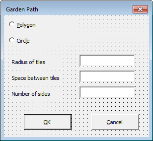

Setting the Properties of the User Form
In the following steps, you set the properties of the user form.
- Select the user form; click in an area on the user form that doesn't contain a control.
- On the Properties window, change the following properties of the user form:
- (Name) = gpDialog
- Caption = Garden Path
The form should look similar to the following illustration:
- Save the project.
