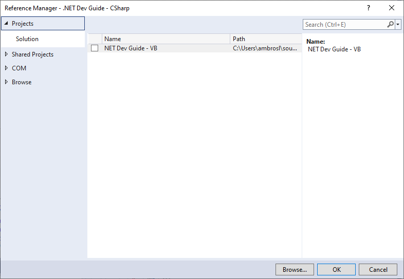

  2. Once the project has been added to the current solution, in the Solution Explorer, right-click the project that you want to add the project reference to and click Add Reference.
  3. In the Add Reference dialog box, Projects tab, select the project you want to reference. Click OK.
    The selected project will appear under the References folder in the Solution Explorer.
