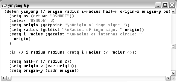

Begin by entering some debugging information in the Visual LISP text editor window containing the yinyang.lsp program.
- Move the cursor in front of the open parenthesis in the line of code that reads:
(setq half-r (/ radius 2))
The following screen snapshot indicates the position of this statement within the program:

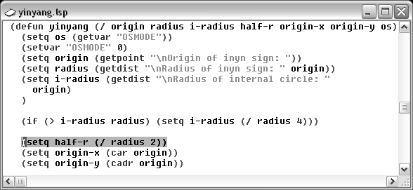

After you reply to the prompts the program displays at the AutoCAD Command prompt, Visual LISP pauses execution at the breakpoint you set and displays the code in the text editor window:
Note how the statement following the cursor is highlighted.
