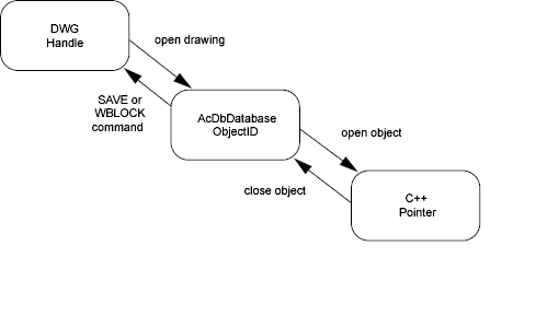

When AutoCAD is not running, the drawing is stored in the file system. Objects contained in a DWG file are identified by their handles.
After the drawing is opened, the drawing information is accessible through the AcDbDatabase object. Each object in the database has an object ID, which persists throughout the current edit session, from creation until deletion of the AcDbDatabase in which the object resides. The open functions take an object ID as an argument and return a pointer to an AcDbObject object. This pointer is valid until the object is closed, as shown in the following figure.
