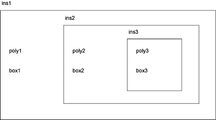

The example that follows shows highlighting nested block references. As shown in the following figure, the example creates six entities: three polys (a custom entity) and three boxes. It also creates three block references (inserts). Insert 3 (ins3) is an insert of a block that contains poly3 and box3. Insert 2 (ins2) is an insert of a block that contains poly2, box2, and ins3. Insert 1 (ins1) is an insert of a block that contains poly1, box1, and ins2.
After the inserts are created, the example highlights the different components.

    // There are six entities in total -- three polys and
    // three boxes (solids). We've named them: poly1, poly2,
    // poly3, and box1, box2, box3. We also have three
    // inserts: ins1, ins2, ins3.
    // ins3 is an insert of a block that contains (poly3, box3)
    // ins2 is an insert of a block that contains (poly2, box2,
    // ins3).
    // ins1 is an insert of a block that contains (poly1, box1,
    // ins2).
    // Let's create these entities first.
