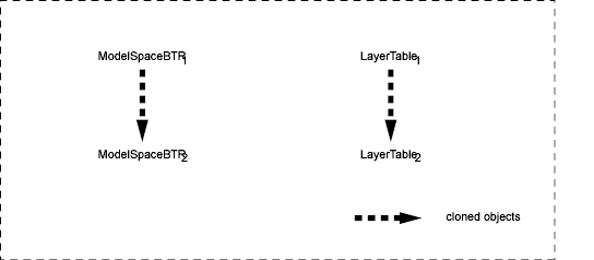

First, at the beginDeepClone() phase, the new database is created and set up with the default elements. The following figure shows the model space block table record and the layer table, because they're relevant to this topic. The cloning that occurs at this stage always happens during a wblock operation.

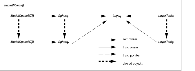

At the beginWblock() stage, the selection set is cloned, as shown in the following figure. In this example, the sphere is cloned.

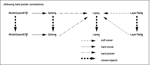

Because the sphere contains a hard pointer to Layer 1 , Layer 1 is cloned.
Next, pointers need to be translated to refer to the cloned objects, as shown in the following figure. The beginDeepCloneXlation() notification indicates the beginning of this stage.
The ID map for the previous figure at the time of beginDeepCloneXlation() is as follows:
ID map of the previous figure |
